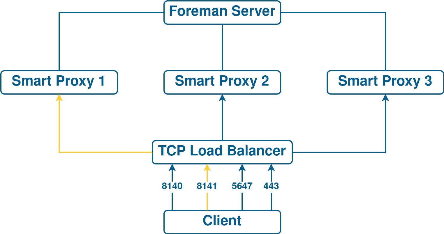

A load-balanced setup consists of the following components:
  • Foreman server
  • Two or more Smart Proxy servers
  • A load balancer
  • Multiple clients
Load Balancing Solution Architecture
Figure 1. Foreman Load Balancing Solution Architecture

In the load-balanced setup, a load balancer distributes load only for the services and features mentioned above. If other services, such as provisioning or virt-who, are running on the individual Smart Proxies, you must access them directly through Smart Proxies and not through the load balancer.
Managing Puppet Limitations
  1. Configure Puppet certificate signing on one Smart Proxy server, typically the first system where you configure Smart Proxy server for load balancing.
  3. Configure a load balancer to redirect CA requests from port 8141 to port 8140 on the system where you configure Smart Proxy server to sign Puppet certificates.
