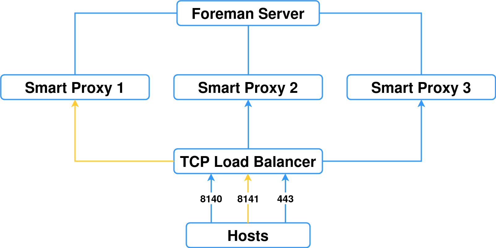

1.1. Components of a load-balanced setup
A load-balanced setup in a Foreman environment consists of the following components:
  • Foreman server
  • Two or more Smart Proxy servers
  • A load balancer
  • Multiple hosts
A host sends a request to the TCP load balancer. The load balancer receives the request and determines which Smart Proxy server will handle the request to ensure optimal performance and availability.
Figure 1. Components of a load-balanced setup

5.4. Managing Puppet limitations with load balancing in Foreman
If you use Puppet, Puppet certificate signing is assigned to the first Smart Proxy that you configure. If the first Smart Proxy is down, hosts cannot obtain Puppet content.
  1. Configure Puppet certificate signing on one Smart Proxy server, typically the first system where you configure Smart Proxy server for load balancing.
  3. Configure a load balancer to redirect CA requests from port 8141 to port 8140 on the system where you configure Smart Proxy server to sign Puppet certificates.

6.5. Managing Puppet limitations with load balancing in Foreman

9. Installing the load balancer
The following example provides general guidance for configuring an HAProxy load balancer using Enterprise Linux 9. However, you can install any suitable load balancing software solution that supports TCP forwarding.
  1. Install HAProxy:
    # dnf install haproxy
  4. Configure the load balancer to balance the network load for the ports as described in Ports configuration for the load balancer. For example, to configure ports for HAProxy, edit the /etc/haproxy/haproxy.cfg file to correspond with the table.
    HTTP
    80
    TCP
    roundrobin
    port 80 on all Smart Proxy servers
    HTTPS and RHSM
    TCP
    source
    port 443 on all Smart Proxy servers
    8000
    TCP
    roundrobin
    port 8000 on all Smart Proxy servers
    Puppet (Optional)
    8140
    TCP
    roundrobin
    port 8140 on all Smart Proxy servers
    PuppetCA (Optional)
    8141
    TCP
    roundrobin
    port 8140 only on the system where you configure Smart Proxy server to sign Puppet certificates
    Smart Proxy HTTPS for Host Registration and optionally OpenSCAP
    9090
    TCP
    roundrobin
    port 9090 on all Smart Proxy servers
  5. Configure the load balancer to disable SSL offloading and allow client-side SSL certificates to pass through to back end servers. This is required because communication from clients to Smart Proxy servers depends on client-side SSL certificates.
