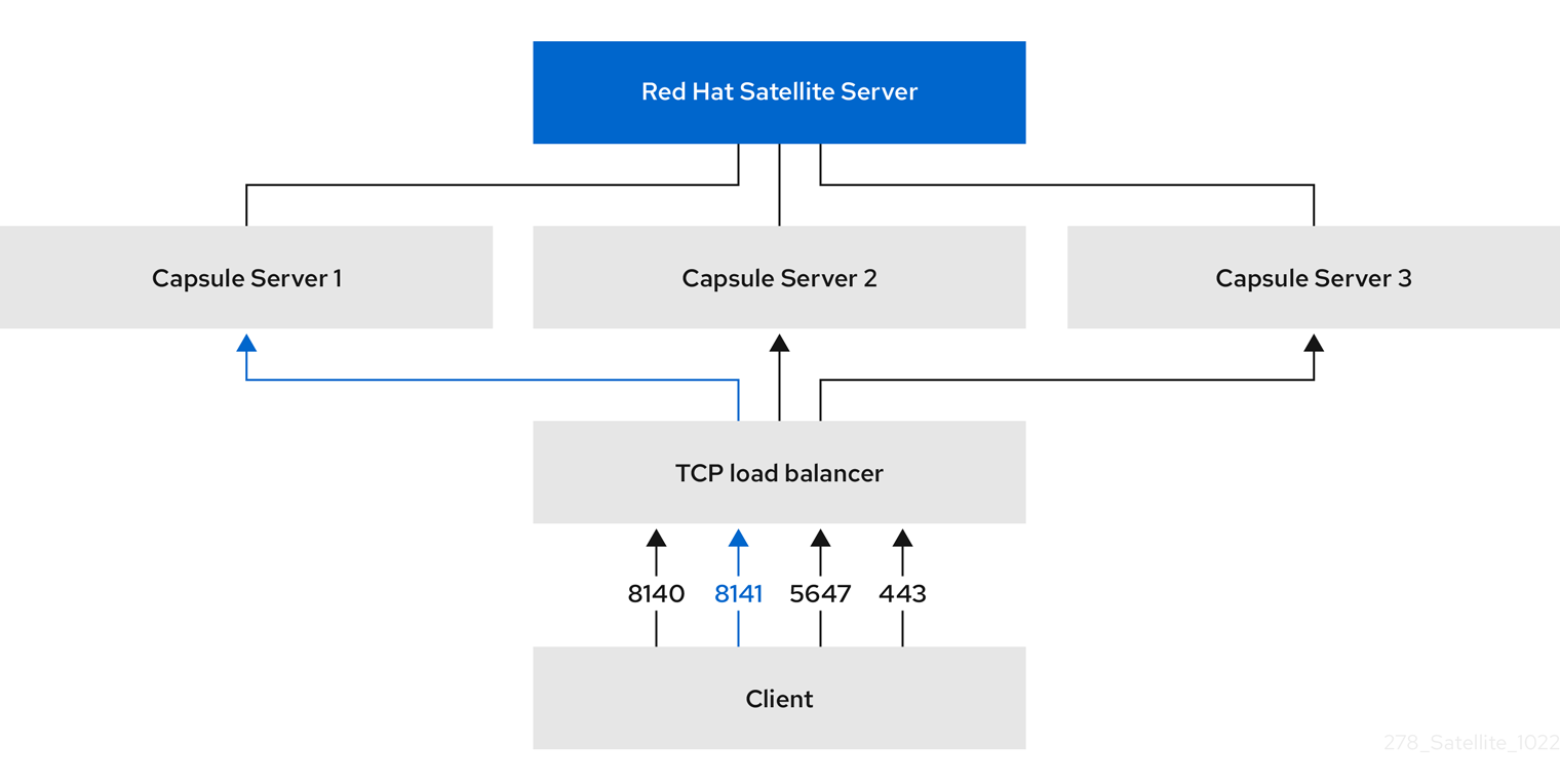

1.1. Components of a load-balanced setup
A load-balanced setup in a Satellite environment consists of the following components:
  • Satellite Server
  • Two or more Capsule Servers
  • A load balancer
  • Multiple hosts
A host sends a request to the TCP load balancer. The load balancer receives the request and determines which Capsule Server will handle the request to ensure optimal performance and availability.
Figure 1. Components of a load-balanced setup

5.4. Managing Puppet limitations with load balancing in Satellite
If you use Puppet, Puppet certificate signing is assigned to the first Capsule that you configure. If the first Capsule is down, hosts cannot obtain Puppet content.
  1. Configure Puppet certificate signing on one Capsule Server, typically the first system where you configure Capsule Server for load balancing.
  3. Configure a load balancer to redirect CA requests from port 8141 to port 8140 on the system where you configure Capsule Server to sign Puppet certificates.
To troubleshoot issues, reproduce the issue on each Capsule, bypassing the load balancer. This solution does not use Pacemaker or other similar HA tools to maintain one state across all Capsules.

6.5. Managing Puppet limitations with load balancing in Satellite

9. Installing the load balancer
The following example provides general guidance for configuring an HAProxy load balancer using Red Hat Enterprise Linux 9. However, you can install any suitable load balancing software solution that supports TCP forwarding.
  1. Install HAProxy:
    # dnf install haproxy
  4. Configure the load balancer to balance the network load for the ports as described in Ports configuration for the load balancer. For example, to configure ports for HAProxy, edit the /etc/haproxy/haproxy.cfg file to correspond with the table. For more information, see Configuration example for haproxy.cfg for HAProxy load balancer with Satellite 6 in the Red Hat Knowledgebase.
    HTTP
    80
    TCP
    roundrobin
    port 80 on all Capsule Servers
    HTTPS and RHSM
    TCP
    source
    port 443 on all Capsule Servers
    8000
    TCP
    roundrobin
    port 8000 on all Capsule Servers
    Puppet (Optional)
    8140
    TCP
    roundrobin
    port 8140 on all Capsule Servers
    PuppetCA (Optional)
    8141
    TCP
    roundrobin
    port 8140 only on the system where you configure Capsule Server to sign Puppet certificates
    Capsule HTTPS for Host Registration and optionally OpenSCAP
    9090
    TCP
    roundrobin
    port 9090 on all Capsule Servers
  5. Configure the load balancer to disable SSL offloading and allow client-side SSL certificates to pass through to back end servers. This is required because communication from clients to Capsule Servers depends on client-side SSL certificates.
