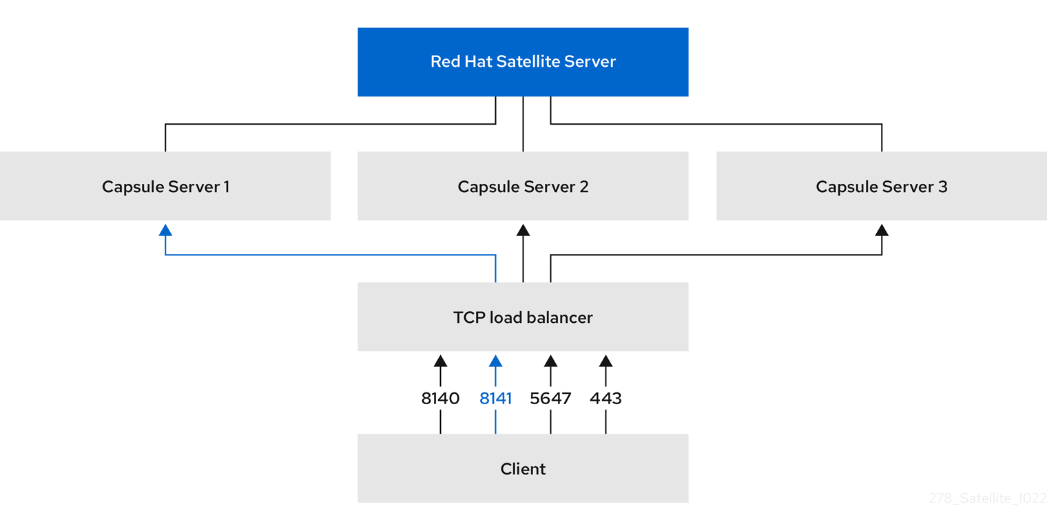

1. Load balancing solution architecture
You can configure Satellite Server to use a load balancer to distribute client requests and network load across multiple Capsule Servers. This results in an overall performance improvement on Capsule Servers.
This guide outlines how to prepare Satellite Server and Capsule Server for load balancing, and provides guidelines on how to configure a load balancer and register clients in a load-balanced setup.
A load-balanced setup consists of the following components:
  • Satellite Server
  • Two or more Capsule Servers
  • A load balancer
  • Multiple clients
Figure 1. Satellite load balancing solution architecture
In a load-balanced setup, nearly all Capsule functionality continues to work as expected when one Capsule Server is down, for planned or unplanned maintenance. A load balancer works with the following services and features:
  • Registration using subscription-manager
  • Content management with Yum repositories
  • Optional: Puppet
In the load-balanced setup, a load balancer distributes load only for the services and features mentioned above. If other services, such as provisioning or virt-who, are running on the individual Capsules, you must access them directly through Capsules and not through the load balancer.
Managing Puppet limitations
  1. Configure Puppet certificate signing on one Capsule Server, typically the first system where you configure Capsule Server for load balancing.
  3. Configure a load balancer to redirect CA requests from port 8141 to port 8140 on the system where you configure Capsule Server to sign Puppet certificates.
